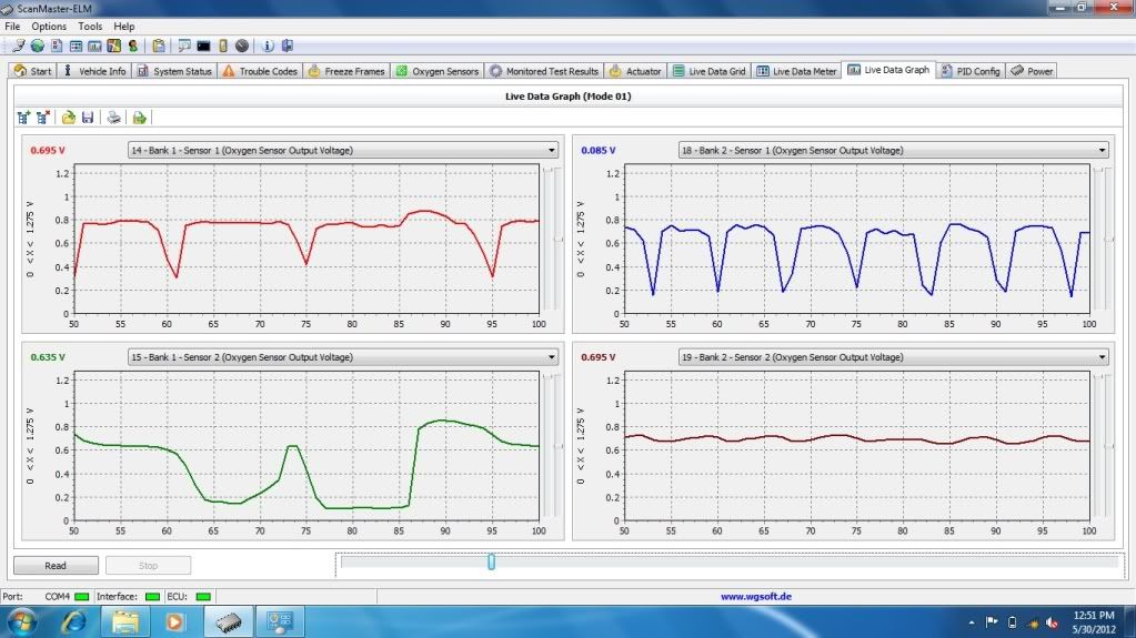

I read about oxygen sensor readings and after analyzing the O2 sensors levels I think I found something.

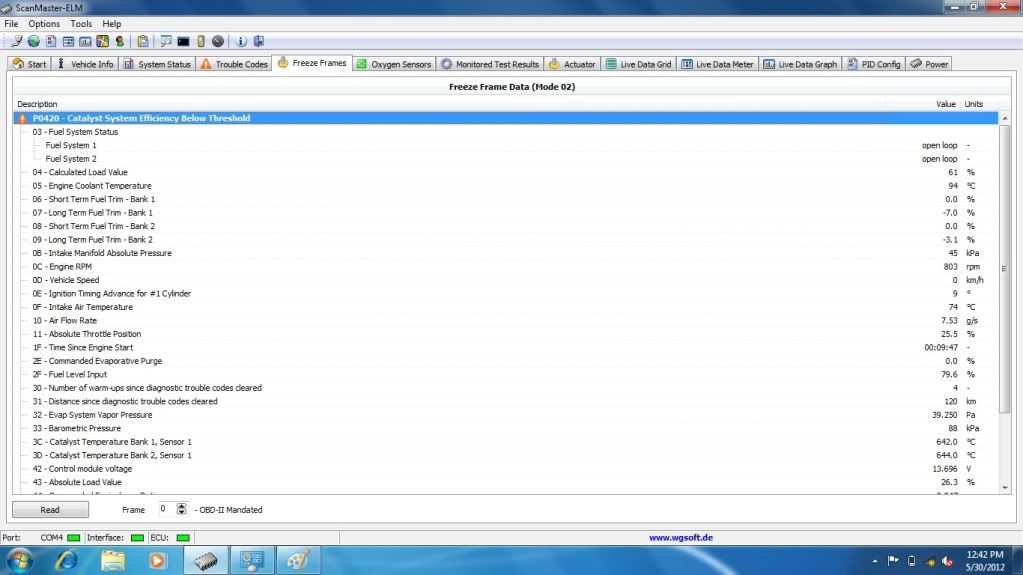

I saw in the last freeze frames that the check engine light always came while I was at 0 MPH, at about 800 rpms, braking on D (I remembered that part, check engine always appeared while I was waiting for a green light).

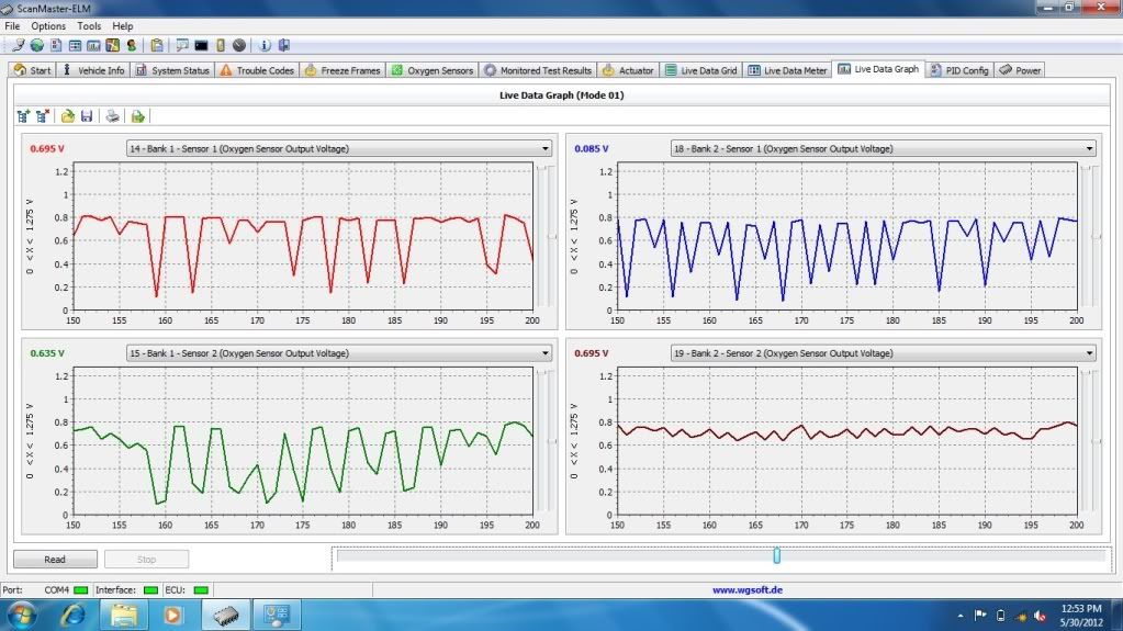

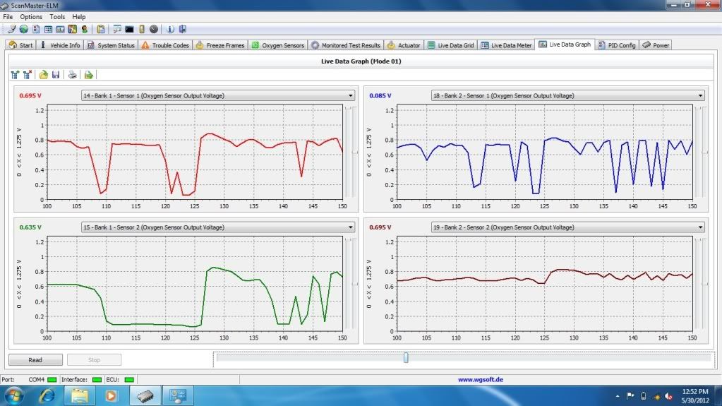

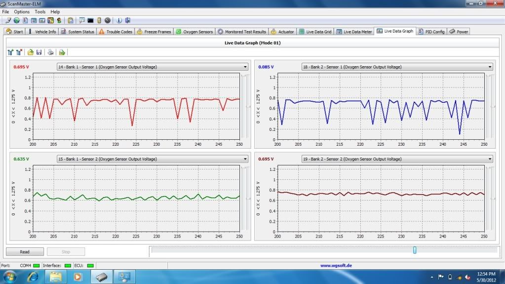

I used Live Data Graph on ScanMaster software to take some O2 sensors readings and found some unstable behavior exactly on bank 1 sensors, just when my car was at idle. But when I revved it (3000-4000 rpms) the readings became little by little as stables as the sensors on bank 2 (they seem to be OK).

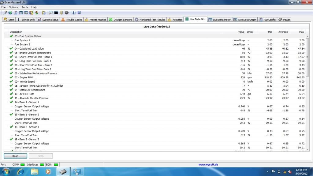

Have some screenshots to show you what I mean.

Freeze Frame Screenshot
Live Data (while I was taking the sensor readings)
Sensor Readings (1-50 Seconds, Idle)

Sensor Readings (100-150 Seconds, Idle)
Sensor Readings (150-200 Seconds, Started to Rev)
Sensor Readings (200-250 Seconds, Revving)

Bank 2 Graphs seem to be OK, but I have no idea what is causing
that unstable reading in Bank 1 Sensor 1 graph. Once it gets stable
(by revving) sensor 2 does too. I think there's something bad in one cylinder on this bank. I dont have any modding on this vehicle, just no cats and those spacers. Cold air intake temporarily removed due to this situation.
