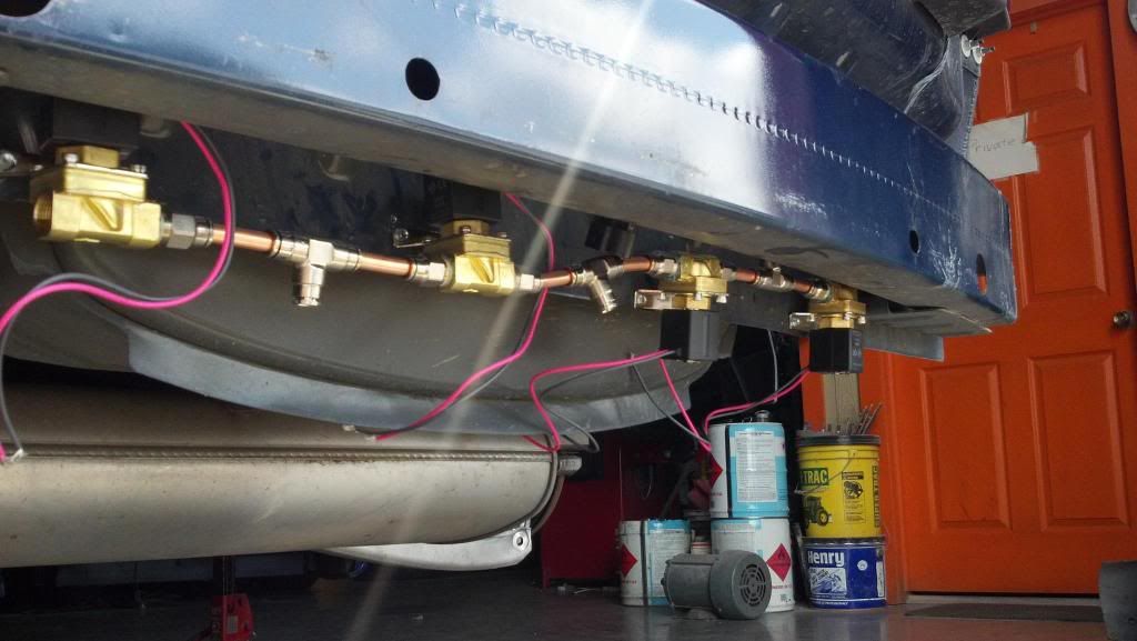

Final drilled in to the body!!

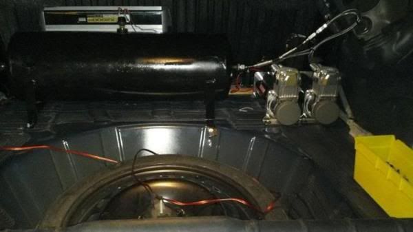

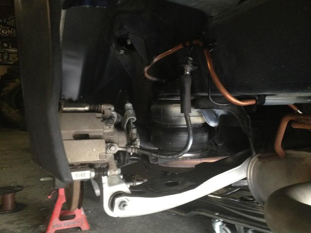

Rear bags and valves

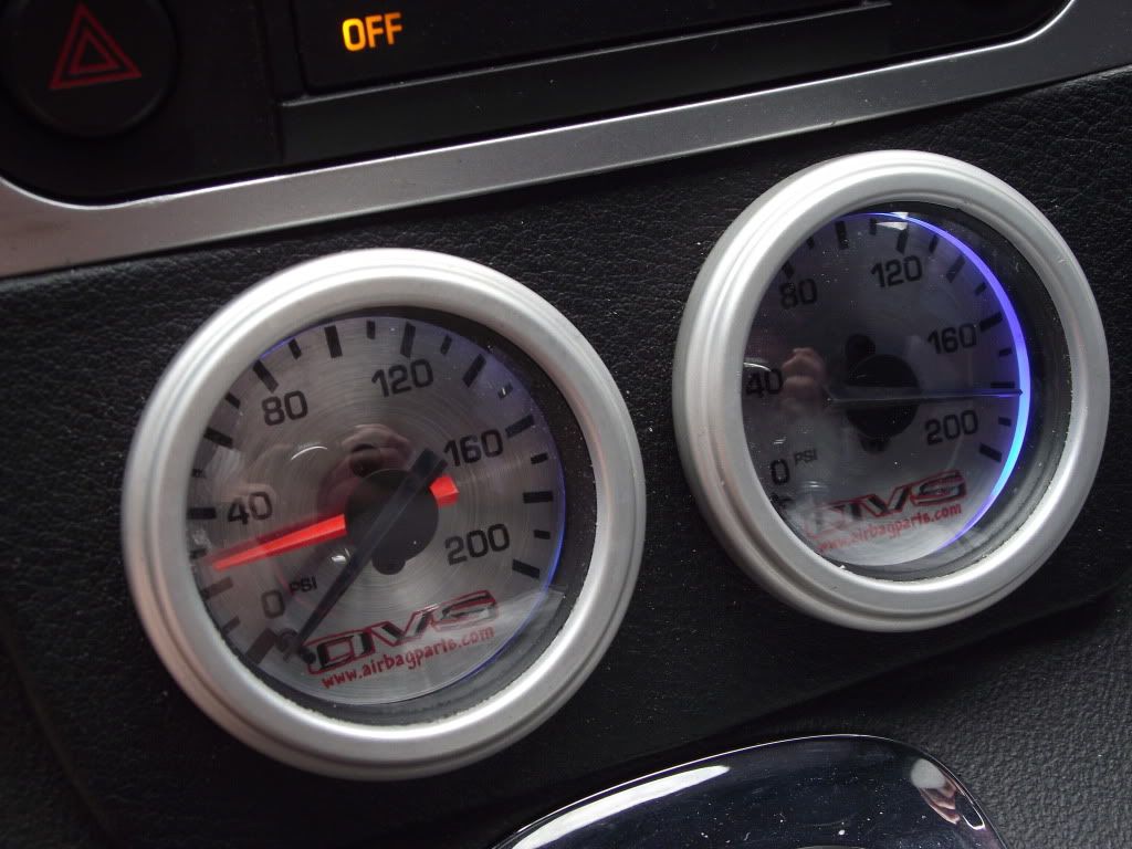

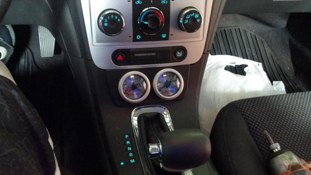

Gauges instal... Removed the i guess the "ash tray spot" and relocated the cig lighter outlet

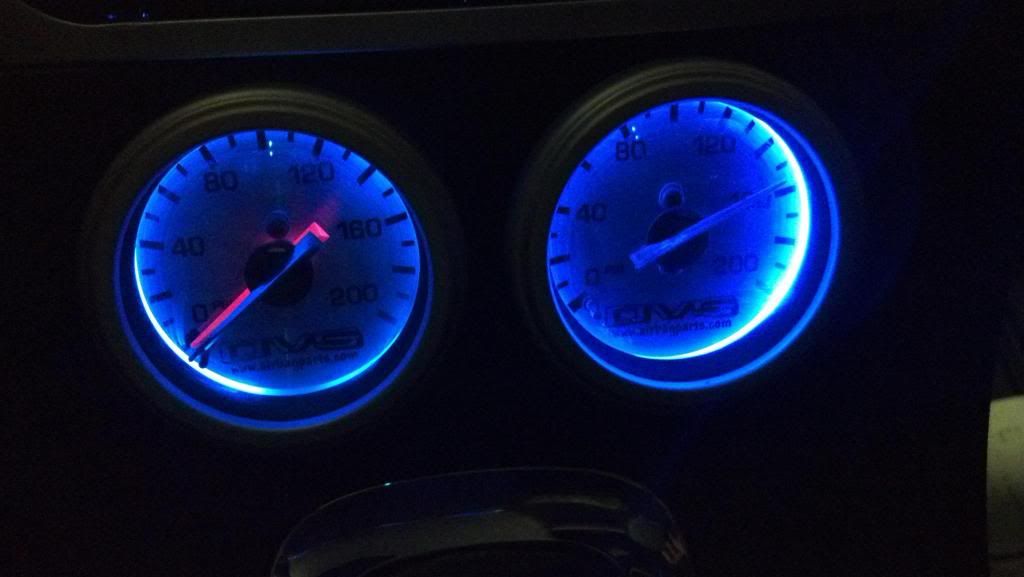

Put the Blue LEDS and we have pressure!!!

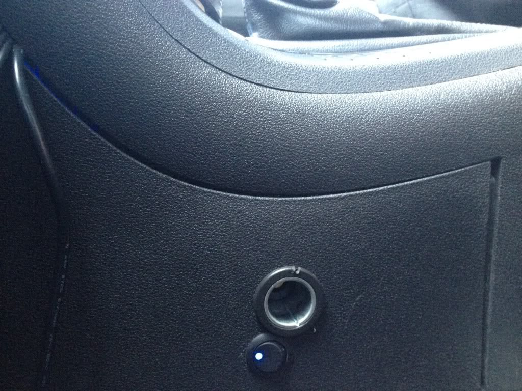

i took some quick pics of where i relocated the cig outlet and my compressor switch to control on or off when i feel like playing with the switchz :cool:
On with the Blue led
and off
ignore the gap and the alignment from the sidewall its my iPhone cable for my doubledin i put out that way and need to adjust or move that to come out the bottom..

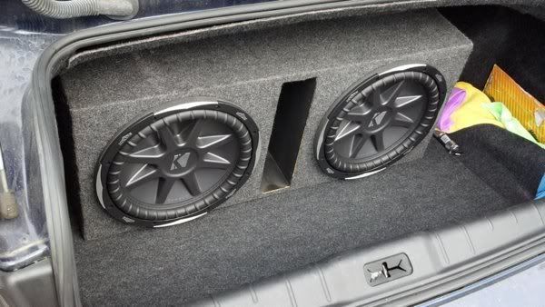

Even with the 7 Gallon air tank and the compressors i still have room for my subs :)

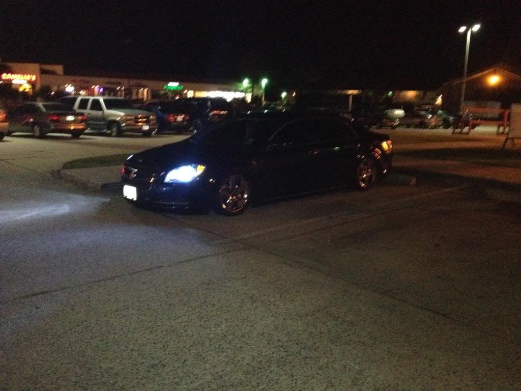

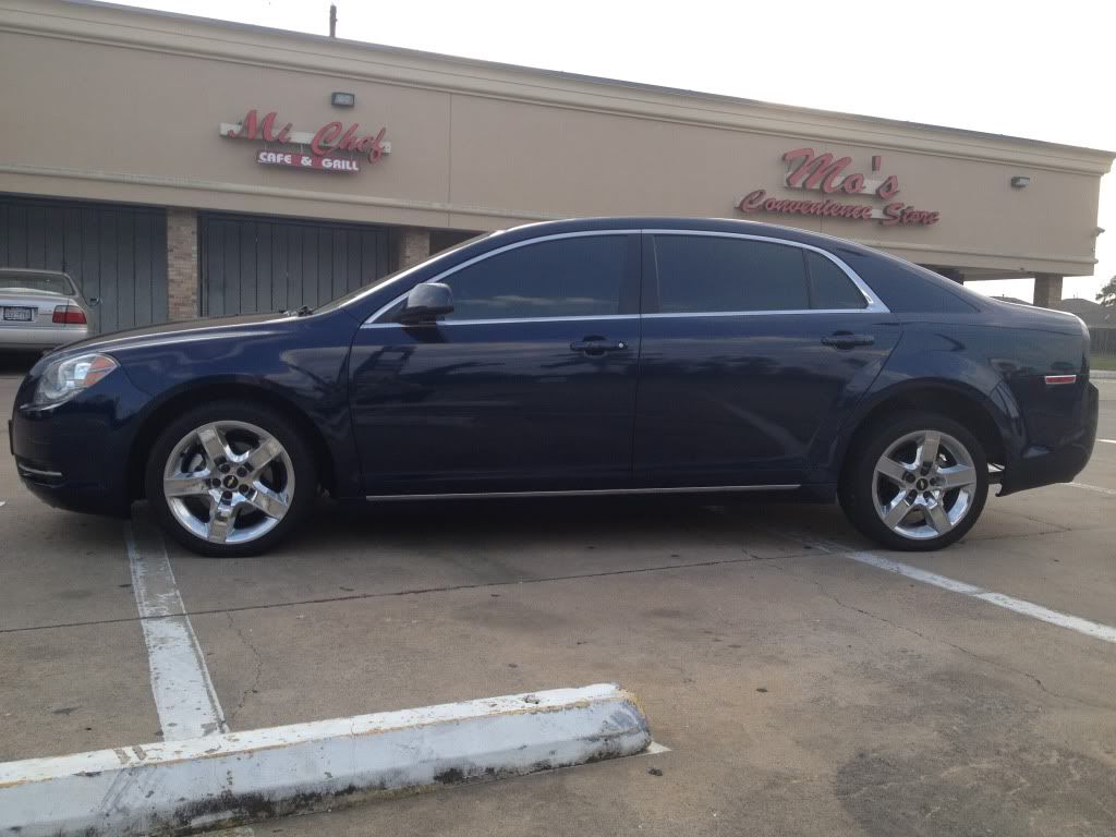

Here is a few pics I have that get a lot of love on Facebook :) I don't try to whore it becuz i still got a lot more i want to do to it... Im saving for the rims so when i do get them.. My Bu will be body dropped once i get them rims.. so i will be the First body dropped on bags :) lots of fab work though.

I am close but not close enough to laying body well probably control arm or frame lol.. but I'm an inch and a 1/4 from laying.. I Need to get shorter struts for the front or fab out the strut mounts for the front..
and for the back I'm bottomed out on my rear shock.. and i looked all over for struts that were smaller that would work.. and the collapsed height of our Malibu struts are 11.53" and sad to say we have one of the smallest shocks in the back... lol.. so i have to relocate the shock and cut into the frame too so the control arm doesn't hit the frame...
heres how high i can get compared to how low i get too
and i do know how to park... the crappy hub caps are from the previous owner... i just havnt taken them off cuz i would rather ride those hub caps that steelies lol.. and to get new ones they are 80 a piece through the dealer.. PSSHH and i aint buying those.. lol...
this is about as high as i can get
Rear height up close..
front up close.. (lol look at my head haha.. just noticed that..)
