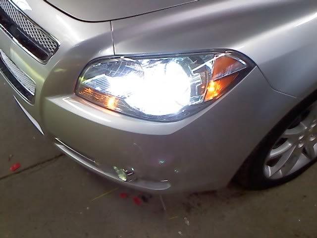

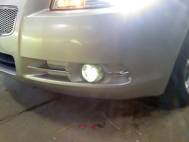

Finished putting in my DDM Tuning hid kits today. Started last night around 11 after putting HID's in my parents legacy. I went with the digital ballasts this time and I have to say they are worth it, even if the only benefit is space savings. nI went with 5k low beam and 3k fog lights the head lights are the only ones on a relay harness. I also painted an LT black grill to match my car and replace my broken LTZ grill, it almost looks like the LTZ grill just a little lighter and more metal flake. I will take some better pictures of the lights tonight.

Headlights only
Fog lights Only
Congrats on the newest mod! Looks like a clean install too.
Thanks. I am a little obsessive when it comes to my car and doing things right the first time:). Maybe too obsessive since between working on my parents car and my car last night I forgot to eat any dinner (I realized that at about 1A.M.):D. I am done for the year on any big mods.
Thank you. These are definitely bright at night and it doesn't have a horrible light beam spread. The 3k's should be really nice when winter hits and the lake effect snow starts to fall. I have always had 6K hid's in my other vehicles, but I think I like the 5K's better.

That job looks like you really took the time to do it well. The fogs have a nice cut off, too. That's how all fog lights should be.

That cutoff of the fogs keeps the beam nicely under control too. I was going to do a how to for the bumper removal with good pictures, but forgot.

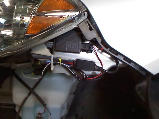

For reference for anyone that needs ideas for how to mount the ballasts, the 3M double sided adhesive tape works really well for this. I got the widest tape possible and cleaned the mounting surface really well with alcohol. The adhesive tape is meant for body moldings, but it works really well for the 1/2 LB ballasts. The location shown by the headlight leaves the wires for the ballast accessible by just pulling the fendwell cover back, and it is the same for the fog lights.
