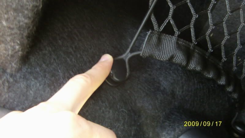

First you need to remove these plugs from the side you want to change the bulb/replace the tail lamp

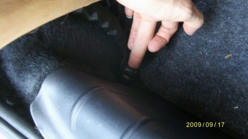

After you remove those you need to twist off the two plug/holder/god knows what to call them things that hold up the net:

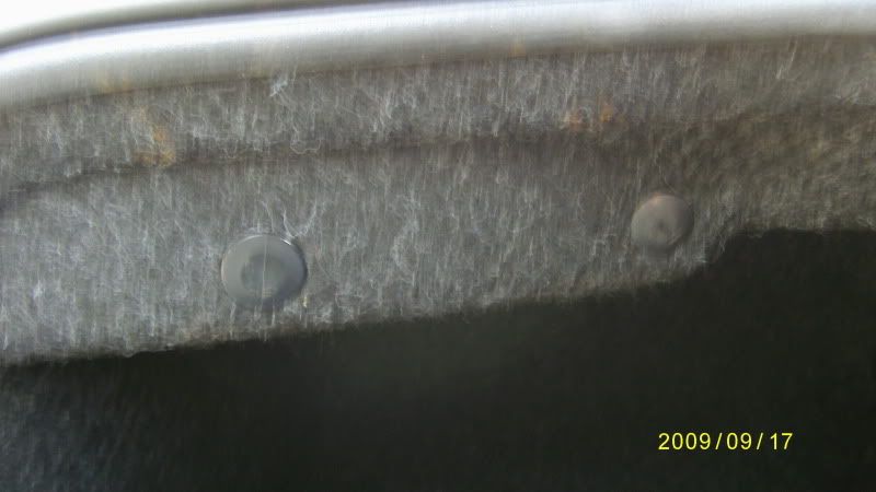

After you remove those, pull the carpet back and there you have to unscrew three plugs that hold the tail lamp on, they are twist off so it's very simple~
And then there you go, Finished.
