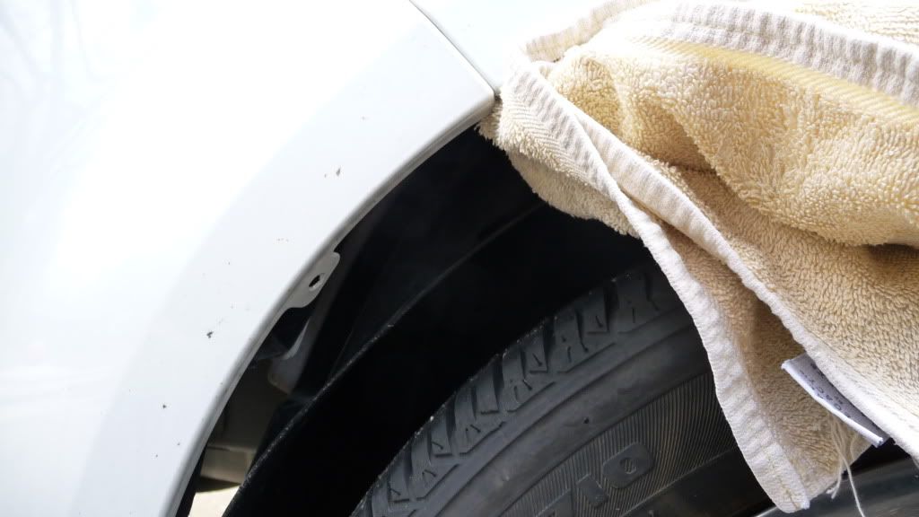

Pull the wheel well back starting at the bottom of the rear bumper and about half way into the wheel well. Use a rolled up hand towel to put between the wheel well and the body to keep the wheel well held back. I used 2 towels. Place 1 at the top of the wheel well, and one at the bottom.

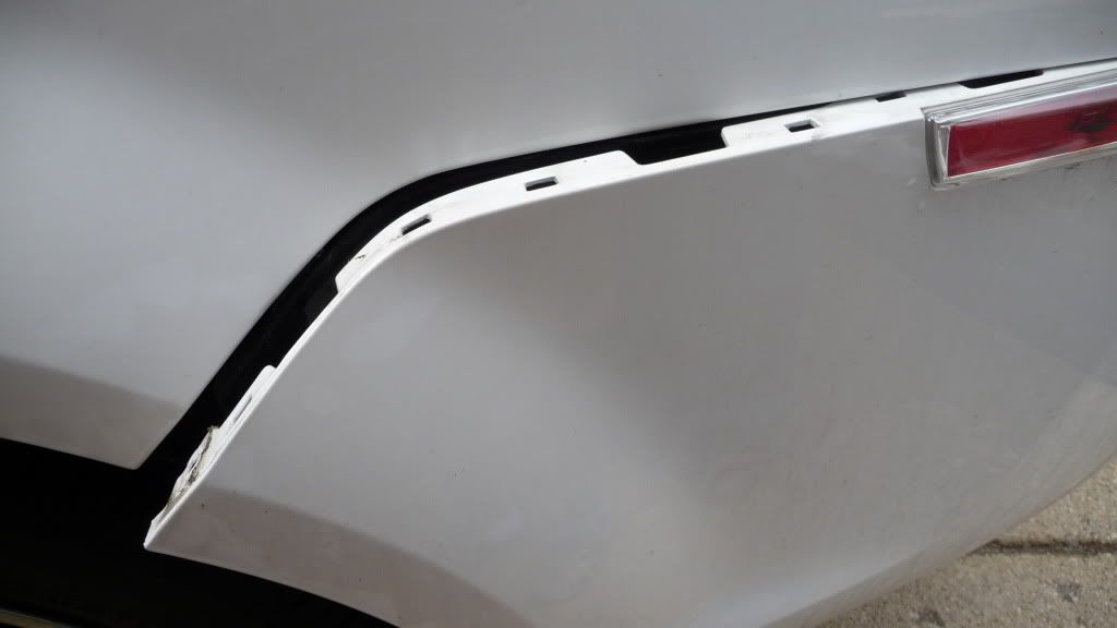

There are a series of retaining clips that hold the top lip of the bumper in below the trunk lid. I was able to pull the bumper out enough to expose them and use a screwdriver to free the bumper from each clip. Watch for the wiring harness for the license plate lamps when you have the bumper free.

I bought my car, Feburary 2010 and just noticed the clips behind the trunk that assist with securing the bumper are not connected..

Thank you everyone for your replies. I also see that 'refreshing' this post brought to the attention of its originator the missing pictures. The clips I see on my car unattached is displayed in Wolf's last picture. What else I find great is Chevy monitoring this website. Nice. Driven, it was your posts that made me a believer of this website. Honest, detailed, instructions. There are many great people here and I knew that I wouldn't be lead into the wrong direction.
