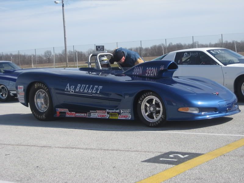

Also interested in your sig and the 06? C5 Corvette drag car. I am into Vettes and have a 10 ZR1. Also got a 10 Colorado Crewcab with V8 and a Magnacharger. On different forums for each and always able to get an answer to problems on each. Thanks again!

If you want to call it a Corvette. Pretty much just a Corvette shaped body. Only things that is real Corvette is the front markers and taillights. Built Dec 2006, but has a C5 body.

Love the Vette video!
