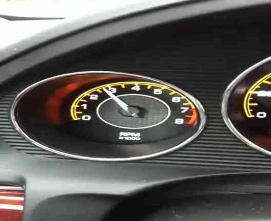

This is for a 09 Aura 2.4 6AT. I know that the 6AT is plagued by complaints of its shifting behaviors and characteristics. I have had the BCM re-flashed by the dealer which helps in some shifting conditions.
But now I've noticed that in cold weather, or more importantly when the vehicle is cold, while accelerating the RPMs jump. This seems to stop when the vehicle is up to operating temp.
Basically, vehicle is going from 2nd to 3rd, RPMs about 3K, the engine revs up, RPMs jump to 3500 or so, then comes right back down. Same going from 3rd to 4th, RPMs at 3200 or so, then the engine revs to 3800, jumps right back down.
It is almost like the transmission is slipping. Any ideas? Or have any 2.4/6AT owners experienced this?

Based on the OP's post it sounds like the tranny is spending some time making the shift between gears and the engine is free to rev for that short instance. That could happen in a tranny that is cold and the shift valves are moving slower than when the oil is hot. I don't think the tranny is slipping. If it was slipping you would notice the rpms increasing without the speed increasing when there was no shift occuring.

My 09 Malibu does the same exact thing when engine is cold... I'm pretty sure it's normal.
