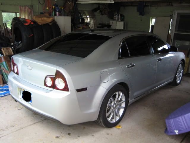

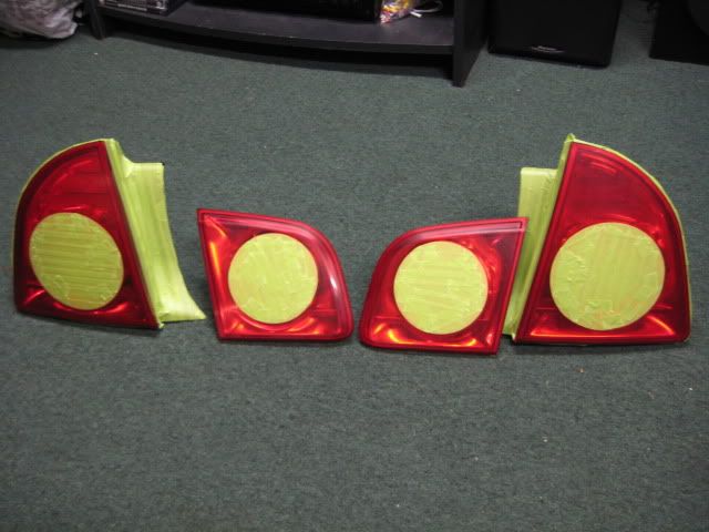

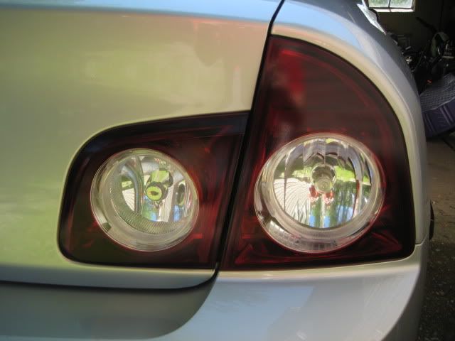

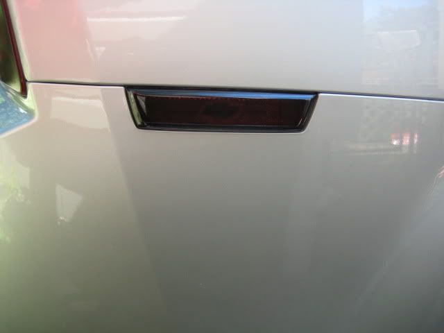

I finished tinting my tail lights and side markers today. Took a good amount of work for prep though. Overall I am happy with them being this is only the second set I have done. The side markers look a lot darker, but they really aren't.
344 Posts
They look real good. Any idea what they have looked like if you had not taped the clear? I think I am going to try this.
I wanted to try this way first to see if I liked it. I think if I didn't tape off the clear it may have been too dark for the LED brake lights to shine through.
If I decide to I can sand it down some and put one more coat on over the whole light to tint the clear part only lightly. Just easier to stop on step short in case I change my mind. One thing I do like is it's different from others. I just really hated the bright red with everything else dark.
Great job on those lights. LTZs are the best candidates for the smoking because if you just painted the red part you don't impede the visibility of the brake lights or signals and still get a very clean look.

Green masking tape, a small exacto knife, VHT nightshades, and time will get you to were you want it. The small groove in the taillight makes things easy for trimming the tape. Follow this how to link and it will come out nice. http://www.350z-tech.com/zwiki/How_to_Smoke_Taillights
One other tip, I have not had good luck with duplicolor clear coat in the past couple years, I would stay away from it. I used plastikote clear doing a couple coats of it. Good luck!
