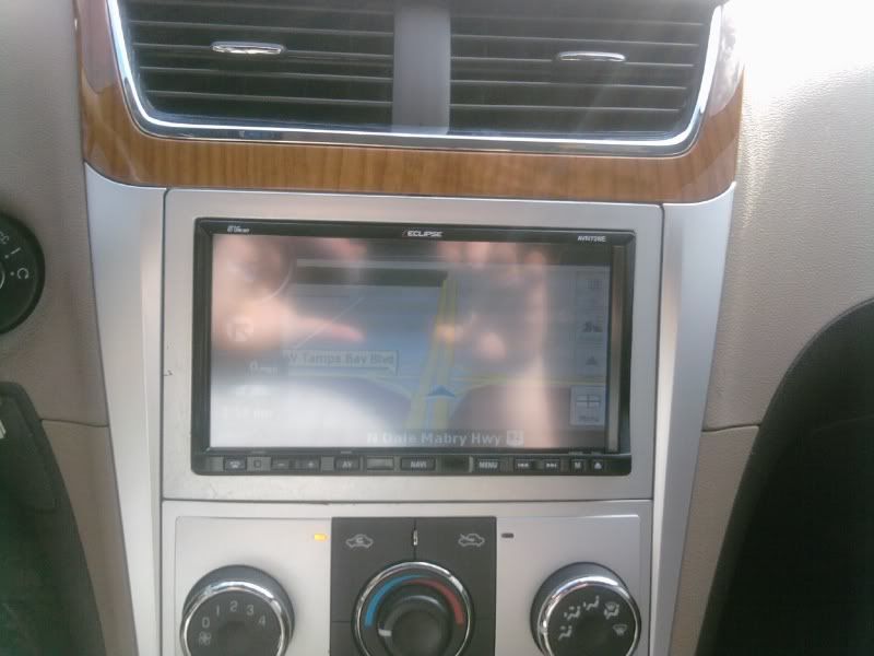

Well, I finally bought and installed my Eclipse unit.
I bought it on Amazon but the seller was Pacific Audio. I love the unit. Right now I have my Ipod hooked up in the glove box and I also by-passed the video lock out so I can watch videos while driving. The Blutooth also works flawlessly. Any more question, just ask.
I did not buy the set-up to keep the steering wheel controls(it is available though). I took the OnStar mic out of its holder and rigged up the new bluetooth mic in its place. Note: you must leave the OnStar mic connected if you want OnStar to function properly, found out the hard way.
